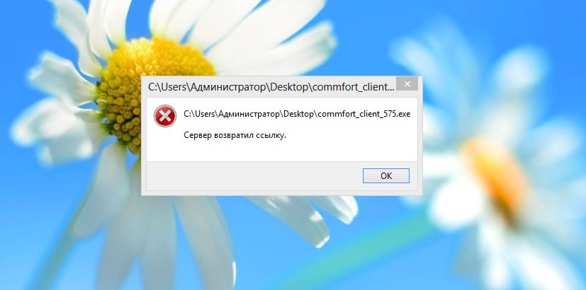

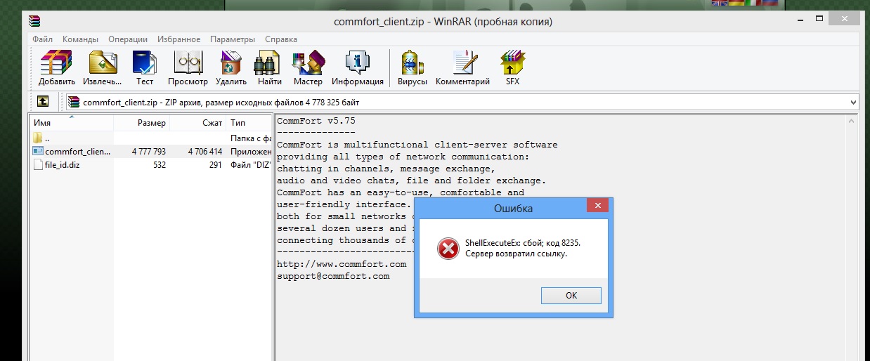

Доброго времени суток. Перехожу по ссылке http://www.commfort.com/download/commfort_client.zip, начинается скачивание клиента чата. Далее распаковка, а потом: http://www.commfort.com/ru/forum/downlo ... ew&id=4074
P.S.: ОСь Windows 8

Проблема повторяется? Какая программа выводит данную ошибку?

обратите внимание на верх скина там написано пробная копия может в этом и есть проблема?

Сегодня в сравнении с прошлым разом, не сразу запускал установку из архива. А сначала извлек клиент чата, и потом только начал устанавливать от имени администратора ...
И вот что получилось: http://www.commfort.com/ru/forum/downlo ... ew&id=4079

Re: Сервер возвратил ссылку
Сообщение bigbag »
Reason:
Some applications will report error code 8235 if not to meet the criteria of Windows Vista / 7. For example, the application is not Digitally Signed or do not have the command line "UIAccess = true" in the manifestation of the program. In cases like this, Vista and 7 require higher access than just a user of Windows (read = Administrator) to conceding access such programs. If the Administrator access level is not available / rejected, then the program will report an error ShellExecuteEx. Vista applications have more complex requirements. Some applications that run smoothly in XP often does not run smoothly on Vista / 7 because the program actually not entirely incompatible.
Problem description
Try to run a downloaded .exe file but get below error message:
1 - A referral was returned from the server
or
2 - ShellExecuteEx failed; code 8235. A referral was returned from the
server
Some such applications can run well in XP but not in Vista.
Cause
Some applications will encounter this if they do not meet some certain
requirements of Vista. For instance, some applications are not signed, or
have no "UIAccess = true" in the manifest resource. Vista decides if
requested execution level of an application requires elevation, and error is
returned by ShellExecuteEx if the elevation is declined. Vista application
has very strict design requirement, some application can run well in XP but
will encounter problem in Vista because they are not fully Vista compatible.
Resolution
1)Run "secpol.msc" -> Security Settings -> Local Policies -> Security
Options
2)Disable "User Account Control: Only elevate executables that are signed
and validated" option
3)Disable "User Account Control: Only elevate UIAccess applications that are
in secure locations" option
4)Restart Windows
Above steps can fix the problem.

По-русски в гуглопереводчике. Для фикса uac в локализованной системе:
1. Win+R -> secpol.msc
- Локальные политики -> Политики безопасности
2. Отключить:
- Контроль учетных записей: повышение прав только для подписанных и проверенных исполняемых файлов
- Контроль учетных записей: повышать права UIAccess-приложений только при установке в безопасных местах
3. Перезагрузка.
